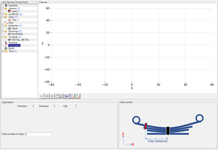

Clip Details
In the Clip details component, you can enter the required number of clips that have to be included in the Total number of Clips text field.
The following section explains the options used in the Clip Details table.
- Direction
- Defines the direction of the clip from center bolt either Front or Rear.
- Distance
- Defines the distance of the clip from center bolt in the ‘direction’ specified.
- Clip
- Depending upon the requirements, you can choose any clip label from the drop-down menu.
Note: Only those clips that are defined in the Clips component are added to the
clip label in the table.
