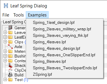

- Examples
- Examples of pre-built leaf spring models are displayed in the list.
