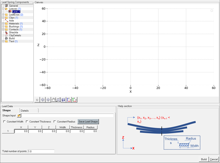

The Leaves component allows you to add a stack of leaves, with each subsequent leaf shorter than the previous one.
- Adding Master Leaf
- The information that has to be entered in the Shape Input and Details tabs is explained in the following sections.
Shape
- X
- Represents the x coordinate of leaf profile
- Z
- Represents the z coordinate of leaf profile.
- Width
- Defines the leaf width. Tip: For constant width, only the first row needs to have the appropriate value, the rest of the rows must be zeroes.
- Thickness
- Defines the leaf thickness. Tip: For constant thickness, only the first row needs to have the appropriate value, the rest of the rows must be zeroes.
- Radius
- Defines the side fillet radius.Tip: For constant radius, only the first row needs to have the appropriate value, the rest of the rows must be zeroes.

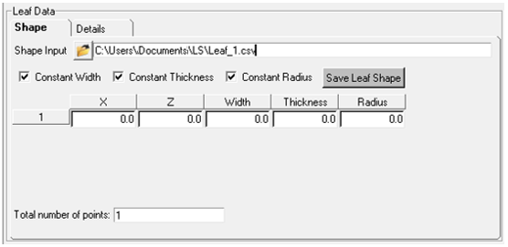

- Constant Width
- Select to have the same values appear along the entire length of the leaf.
- Constant Thickness
- Constant Radius
- Save Leaf Shape
- Saves the entered leaf data in a .csv file format.

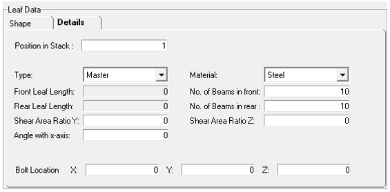

Details
The options used in the Details tab are explained below.
- Position in Stack
- Defines the position of the leaf in a leaf stack, in simple terms the serial number.

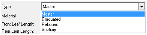

- Type
- Defines the type of a leaf.

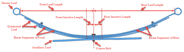

- Master: The top leaf in the spring which has the spring eyes.
- Graduated: Remaining leaves are called as Graduated leaves, with varying lengths.
- Rebound: Any leaf that appears above the master leaf and is part of the pack.
- Auxiliary: These are usually the helper leaf modeled at the bottom of the pack, to provide additional stiffness, whenever system is at a certain jounce.
Figure 4. Available Leaf Types
- Material
- Defines the material used in a leaf.
- Front Leaf Length
- This is a read-only field and its values are auto-calculated. It provides length for the front half of the leaf from the center bolt.
- Rear Leaf Length
length for the rear half of the leaf from the center bolt.
For leaves with eyes, the length (Front/Rear) will be up to the point where the leaf starts curving into the eye profile. In other words, it indicates that length of the leaf which needs to be discretized using beam elements.
- No. of Beams in front
- Represents the number of beam elements that will make up the front half of the leaf.
- No. of Beams in rear
- Represents the number of beam elements that will make up the rear half of the leaf.
- Shear Area Ratio Y
- Defines the shear ratio along Y direction.
Specifies the shear area ratio in the y direction for Timoshenko beams. This quantity accounts for shear deflection in the Y direction. This is defined as:
Qy is the first moment of the cross-sectional area to be sheared by a force in the y direction. lz is the cross section dimension in the z direction. Iyy is the area moment of inertia about the beam y-axis. To neglect shear deformation in the y-direction, set ASY=0. ASY ≥ 0
- Shear Area Ratio Z
- Defines the shear ratio along Z direction.
Specifies the shear area ratio in the z direction for Timoshenko beams. This quantity accounts for shear deflection in the Z direction. This is defined as:
Qz is the first moment of the cross-sectional area to be sheared by a force in the z direction. ly is the cross section dimension in the y direction. Izz is the area moment of inertia about the beam z-axis. To neglect shear deformation in the z-direction, set ASZ=0. ASZ ≥ 0
- Angle with x-axis
- Angle of the leaf with x-axis that is positive in the counter-clockwise direction and negative in the clockwise direction.
Refer to the Leaf List for Leaf Property file section for more information on how it is represented in the TiemOrbit file format.

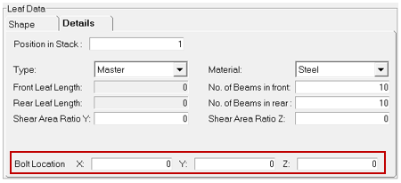

Bolt Location
Bolt Location is required only if the shape condition is Pre-Assembly. It provides the bolt location of a leaf as its reference location and generates correct leaf profiles from Pre-Assembly shape condition.
Refer to the Bolt Location for Leaf Property file section for more information on how it is represented in the TiemOrbit file format.

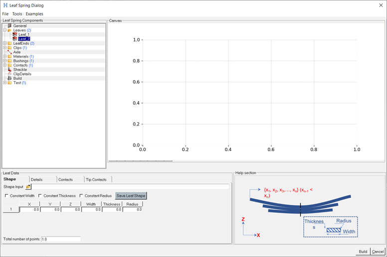

Adding Additional Leaves to the Leaf Stack (Graduated and Auxiliary Leaves)
Additional leaves can be added to the Leaves component and you must define the necessary points in the contact table to have contact between the upper leaves.

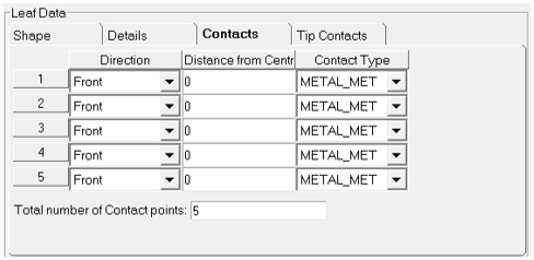

Contact Points
Contact points provide contact between the current leaf and upper leaf. In this section, define the number of contact points and enter the required data in the table.
- Contact Number
- Defines the serial number of contact points which should be unique for the front and rear direction.
- Direction
- Defines the direction of contact from the center bolt.
- Distance from Center
- Defines the distance of contact from the center bolt along the leaf length in either front/rear direction. While mentioning this, you will have to note the lengths of the current leaf and the leaf above it.
- Contact Type
- Defines the label of the contact properties that you have define in the contact properties component.
Refer to the Contact Table for Leaf Property File (*lpf) section for more information on how it is represented in the TiemOrbit file format.

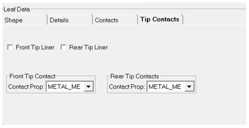

Tip Contacts
- Tip Liners
- Tip liners are usually present in the leaf ends. Tip liners influence how
the spring works. They are used to reduce the interleaf friction. Depending
your needs, tip liners may have to be invoked. Tip liners can be at both

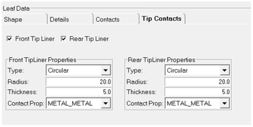

ends or at one, as per your requirement. The options used for Circular type are explained below:
- Type
- Defines the shape of the tip liner.
- Radius
- Defines the radius of the tip liner.
- Thickness
- Defines the thickness of the tip liner.
- Contact Properties
- Defines the label of the contact properties that you have defined in the contact properties component.
Figure 9. Leaf Data - Tip Contacts Tab with Tip Liner Option 'Off'
Figure 10. Leaf Data - Tip Contacts Tab with Tip Liner Option 'On'

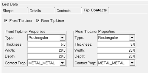

The options used for Rectangular type are explained below:- Type
- Thickness
- Width
- Defines the width of the tip liner.
- Depth
- Defines the depth along the leaf.
Figure 11. Tip Liner Fields in Leaf Details
Refer to the Tipliner Front/Tipliner Rear for Leaf Property File (*lpf) section for more information on how it is represented in the TiemOrbit file format.
