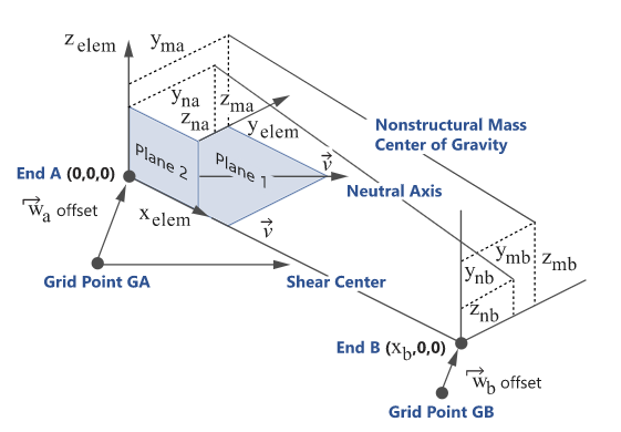

- Element topology (2 or 3 nodes)
- An orientation method aiming to define the element system
- A cross section with section properties
- Defined by a Centroid (or Neutral axis) and Shear Center
- Defined in a local 2D system (YZ plane) with Origin
- A reference point that matches with the element’s node
- Optional offset
- Shift the default reference point to a certain amount
- Some solvers support offset at element level while some others define offset at section’s property level (assigned to multiple elements).
- Some solvers can define different offsets at each end of a beam while others may limit to a constant offset.
- Offset components could be defined in various systems.
- Default reference point and sign convention may change depending on solver.

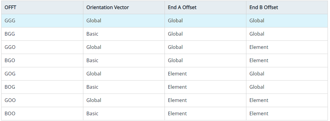

The offset components are stored at element level. This provides a provision to bulk update several elements without considering associated properties. Offset components are resolved based on OFFT string parameter.
Most of the offset tools described above will automatically apply offset values (End A & End B) in elemental system. Hence, OFFT will be automatically updated while using these tools (keeping the first letter unchanged for Orientation).
Setting the offset values directly using the Offset Component method honors the system option selected (Basic or Global).
