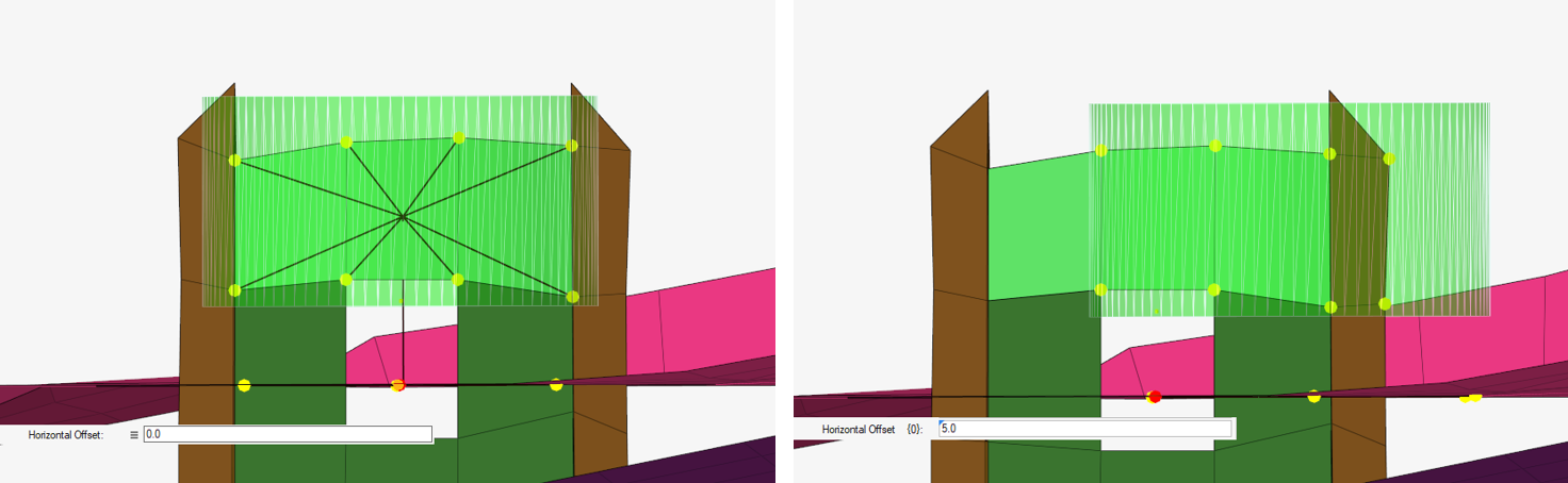

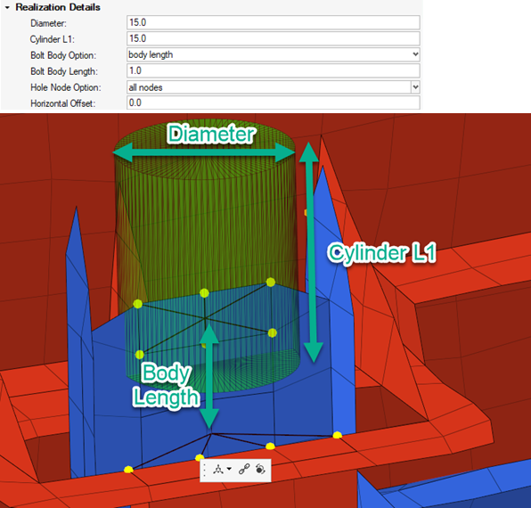

The Diameter, Cylinder L1, Bolt Body Option, Bolt Body Length, Hole Node, and Horizontal Offset options, defined in Figure 2, control the node selection for the parts being clipped.
The number of elements that are selected for the realization on the loop part (red) is controlled by the width of the diameter. The diameter also controls the number of nodes selected in the penetrating part (blue).
The Cylinder L1 option controls the height of the search Cylinder.
The Bolt body option can be set to “auto body length” or a defined body length. A defined body length will create the body element from the base element up the desired length (See graphic below). Auto body length will create a body element from the centre of the found groups of elements.
