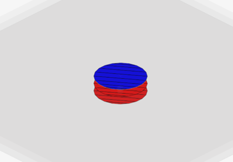

Rigid Patch
The Rigid Patch realization is a common modeling practice for the Explicit Analysis where the bolts are represented with a rigid mesh and Constrained Rigid Bodies are used to tie the various subsystems together.
| Profile | Support |
| LS-DYNA | Constrained Rigid Bodies, Mat20 on the Patches |
| OptiStruct | Rigid Bodies, RBODY and RBADD |
| Radioss | GROD of nodes and RBODY of the GRNOD set Note: If you use
Attachments with Rigid Element, this realization will
generate a Merge_RBODY instead. |
