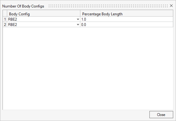

- Body Configs
- The element type between each hole layer. If it is greater than 1, it can be
adjusted via a table. The Percentage Body Length allows the relative lengths
of each of the Elements within the body to be defined. Figure 10 shows one element with
Percentage Body Length set to the full length and another element with
Percentage Body Length set to zero connected at the end.
Figure 10.
