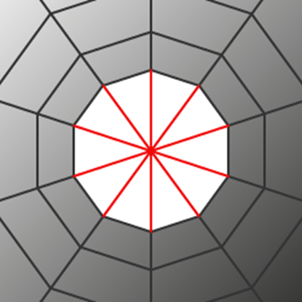

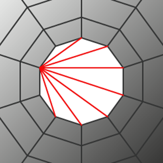

- Create Head
- Allows the creation of an element per hole or prevents it. Figure 1 and Figure 2 demonstrate the difference
in the realization with these options.

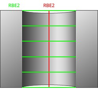

- Bolt Length
- The definition of the length of the body element.
Figure 3.
- Hole Gap
- Creates a body element with a length defined by the distance between the holes.
- Body Length
- Creates a body element with a specified length.

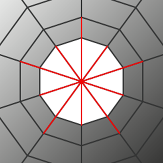

- Body Configs
- The element type between each hole layer. If it is greater than 1, it can be
adjusted via a table. The Percentage Body Length allows the relative lengths
of each of the Elements within the body to be defined. Figure 4 shows one element with
Percentage Body Length set to the full length and another element with
Percentage Body Length set to zero connected at the end.
Figure 4.

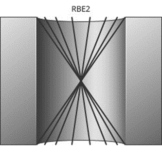

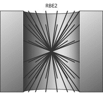

- Solid Hole
- Can be used to define the Connectivity within Solid Holes. There are
four different styles defined with the realization on the Solid Hole
being isolated.
Figure 5. Edge
Figure 6. Interior
Figure 7. Layered Edge
Figure 8. Layered Interior
