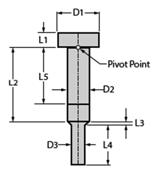

Figure 1. Pattern 1: Tapered Bolt

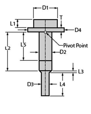

Figure 2. Pattern 2: Tapered Bolt with Washer

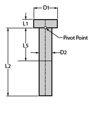

Figure 3. Pattern 3: Straight Bolt

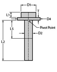

Figure 4. Pattern 4: Straight Bolt with Washer

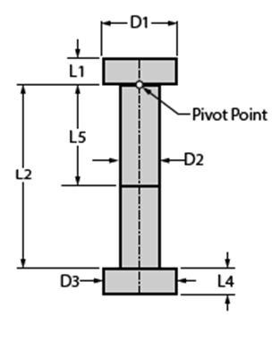

Figure 5. Pattern 5: Double Sided Bolt
- D1
- Diameter of the bolt head
- D2
- Input
- A manually defined diameter of the bolt shaft
- Auto
- The connector will automatically take the diameter of the smallest hole and set it as the diameter of the bolt shaft.
- D3 (Patterns 1, 2, and 5 Only)
- The diameter of the tapered section of the bolt (pattern 1 and 2), or the diameter of the double-sided bolt (pattern 5)
- D4 (Patterns 2 and 4 Only)
- Diameter of the washer
- L1
- Length of the bolt head, excludes the thickness of the washer
- L2
- Length of the main section of the shaft of the bolt
- L3
- Transition zone between the tapered section of the shaft of the bolt and the main shaft of the bolt
- L4 (Patterns 1 and 2 Only)
- The length of the tapered section of the bolt (patterns 1 and 2), or the length of the double-sided bolt (pattern 5)
- L5
- The position of the pretension section
- T (Patterns 2 and 4 Only)
- The thickness of the washer

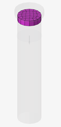

- Failure (LS-DYNA Only)
- This will create a layer of elements under the head of the bolt with
hour glassing and a rupture material so the failure of the bolt can be
modeled.
Figure 6.
- Rupture Material
- An optional selector that can be used to define an existing material for the failure elements. If left empty, a new material will be created for the realization.

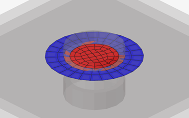

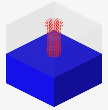

- Implicit Solver Interfaces
- For the Implicit solver interfaces (OptiStruct and Abaqus), under the head of the bolt
is modeled separately as a contact.
Figure 9.

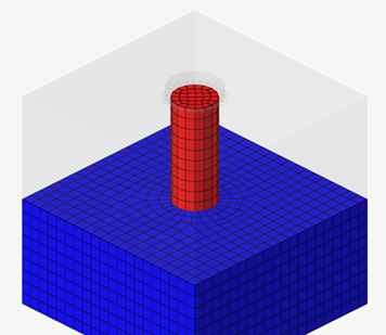

- Shaft Contact Type: (OptiStruct/Abaqus Only)
- Tied
- A tied contact is created for the shaft of the bolt and the
last link of the connector.
Figure 10.

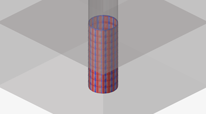

- Threaded (Solid Links Only)
- Last Part
- A contact patch will be created between the
inner face of the solid hole and the face of the
bolt shaft.
Figure 11.

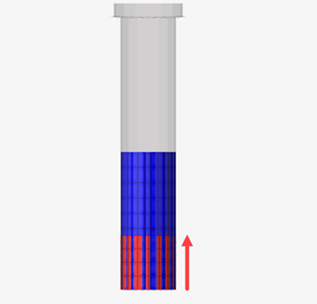

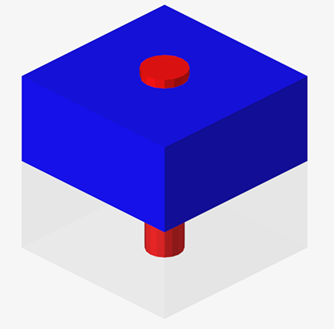

- Contact Length
- Measured from the bottom of the bolt, the
contact thread on the bolt will be the specified
thread length.
Figure 12.
