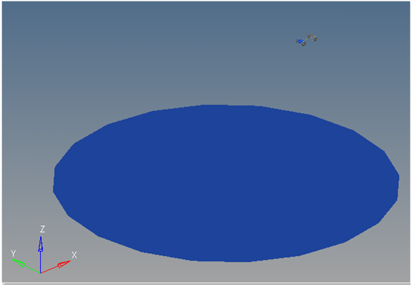

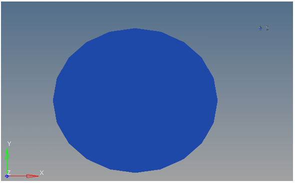

One graphic is defined in the event. The graphics define the road surface graphics and should not require any user input. A full description of the graphics can be found here.
Skidpad graphics are included to illustrate the path being driven, and are defined parametrically using the data in the Braking in a Turn event form. Skidpad graphics should never require editing unless the event is being fundamentally changed.
