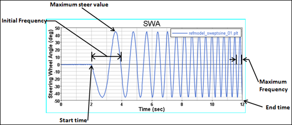

A sinusoidal steering input at the steering wheel determines the frequency response characteristics of the vehicle. The vehicle velocity of 45 mph is kept constant throughout the event. After two seconds, the vehicle steers from its initial value to its maximum steering value, which is 45 degrees with a frequency increase rate of 0.2750 Hz/sec. This event covers a minimum frequency range of 0.25 to 3 Hz. This event helps to determine the steering wheel angle, yaw rate, roll angle, and lateral acceleration.

Note that the maximum frequency is a frequency limit only. The actual maximum frequency obtained in the simulation is a function of the Initial frequency, the frequency rate, and the start and end time. The steering wheel sine wave begins at the initial frequency at the start time and increases by the frequency rate each second until the event ends at the end time. The maximum frequency only comes in to effect if the end time is mismatched with the frequency rate.
