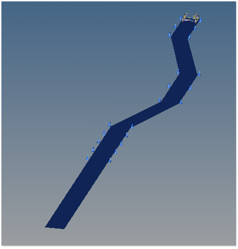

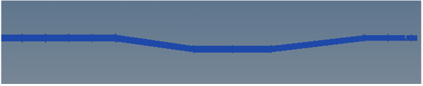

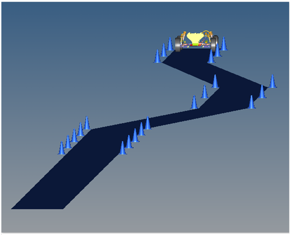

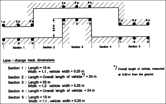

A Double Lane Change event drives the vehicle through a lane change and a return to lane maneuver, attempting to follow the centerline of the defined lane. You can define the speed of the lane change, along with the lane dimensions. A steer controller is used to follow the path and a drive torque controller is used to maintain speed throughout the event. The event supports right and left lane changes. A plot template is available to plot the results.
The Double Lane Change event path is shown in the diagram above. Lane dimensions are entered in meters and are translated to millimeters in the various locations they are used (point parametric definitions, solver arrays, and so on). The lane graphics are defined from the path dimensions and are used to illustrate the path. The road surface used by the tire is defined by the .rdf file in the tire system and is independent from the graphics.

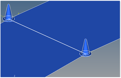

Twenty seven graphics are defined in the event. The graphics define the cones and the road surface graphics and should not require any user input. A full description of the graphics can be found here.
The road graphics are included to illustrate the path being driven and are defined parametrically using the data in the Double Lane Change event form. All road graphics are used to illustrate the lane dimensions, but are not of the actual road used for calculating tire forces. Road graphics should never require editing unless the event is being fundamentally changed.

Thirty five points are defined in the event. Points are used to create the lane graphics and graphics for the cones used to illustrate the lanes. The points contain parametric logic to define their X, Y, and Z locations. You should not need to modify any points.

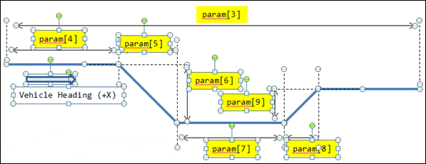

The Double Lane Change event contains a solver array called Lane Parameters that defines the path that the vehicle has to travel.
| Parameter Number | Value | Description |
| 0 | 1 | Lane type (1=Double lane change). |
| 1 | 1 | Interpolation type (1=Cubic). |
| 2 | 0 | First lane change direction (Left=0, Right =1). |
| 3 | 125000 | Total length (mm). |
| 4 | 15000 | Distance to start of lane change (mm). |
| 5 | 30000 | First Lane Change: Longitudinal distance (mm). |
| 6 | 3500 | First Lane Change: Lateral distance (mm). |
| 7 | 25000 | Distance from end of the first lane change to the start of the second lane change (mm). |
| 8 | 25000 | Second lane change: Longitudinal distance (mm). |
| 9 | 3500 | Second lane change: Lateral distance (in opposite direction to first lane) (mm). |
The data point values in the solver array are obtained from the Full Vehicle Data dataset.
Lane data is converted from meters to millimeters in the Data Point panel. The data is
passed to the CURSUB subroutine using the idstring of this array.

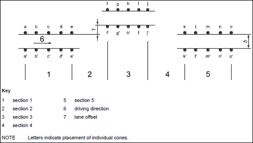

ISO 3888-2-2011 Passenger cars — Test track for a severe lane-change maneuver.
NATO Allied Vehicle Testing Publication AVTP: 03-160 Sep. 1991.
