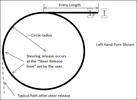

A Steer Release in a Turn event simulates a vehicle cornering at a constant radius and the dynamics of the steering wheel being released while in the corner. A steer controller is used to drive the constant radius curve, a drive torque controller is used to maintain a constant speed, and standard outputs for the vehicle and tires are included in the tire system and the output requests system. A plot template is available to plot the results.

| Varies | Constant Radius | Vehicle enters the constant radius corner and should settle into steady state cornering prior to the steering wheel being released. |
| Steer Release Time | Steering Wheel is Released | The steer controller no longer steers the vehicle. Steering wheel is free to rotate on its own. |

The entry length straight road section is included to allow the vehicle model to settle into steady-state, straight line driving. The vehicle turns into the constant radius corner and should be allowed to reach steady-state cornering before releasing the steering wheel.

- The default settings of the event result in a vehicle that drives approximately ¼ of the constant radius circle when the steering wheel is released.

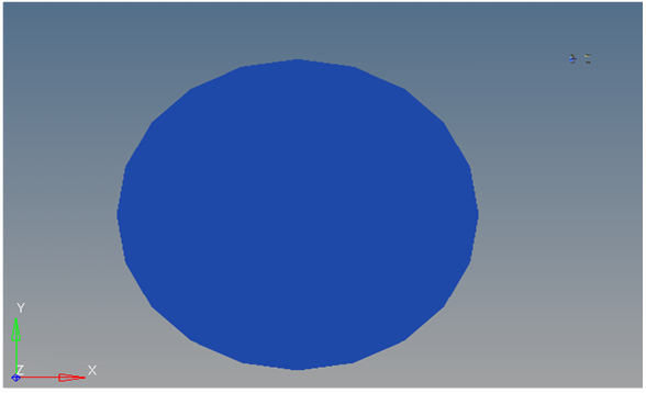

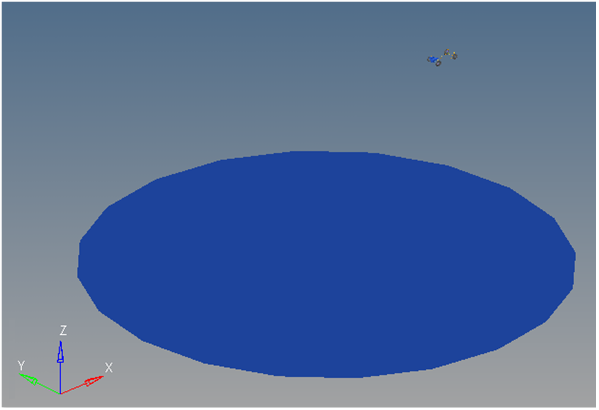

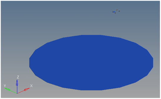

One graphic is defined in the event. The graphics define the road surface graphics and should not require any user input. A full description of the graphics can be found here.

One marker is included in the event. The path origin is the origin of skidpad graphics and is parametrically defined to be the CG of the vehicle body. The markers refer to points and the points contain the parametric logic.

Points
Two points are defined in the event. All points are used to create the skidpad graphics. The points contain parametric logic to define their X, Y, and Z locations. You should not need to modify any points.
