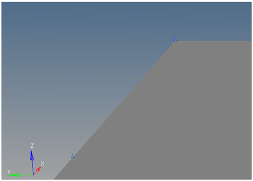

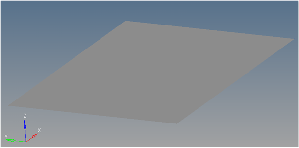

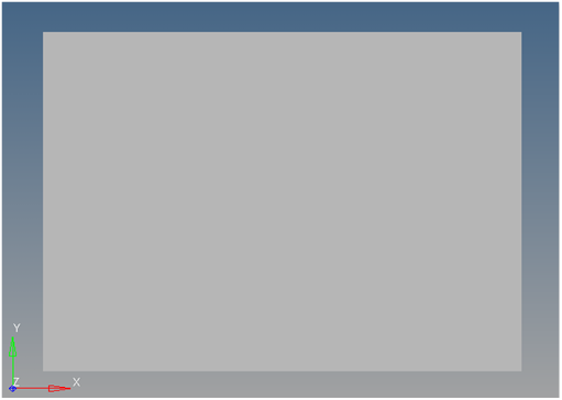

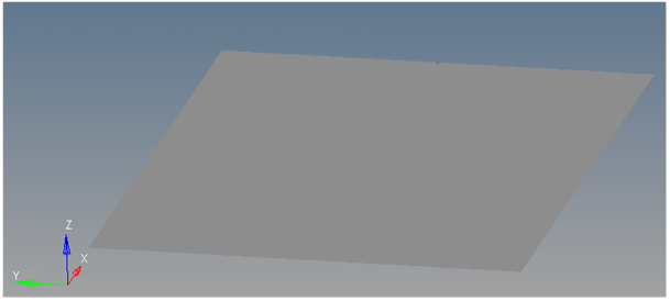

Seven graphics are defined in the event. The graphics define the cones and the straight road graphics and should not require any user input.The straight road graphics are included to illustrate the path being driven and are defined parametrically using the data in the Sinusoidal steering form. Straight road graphics should never require editing unless the event is being fundamentally changed.
Figure 3. Cone Graphics
Figure 4. Straight Road Graphics
