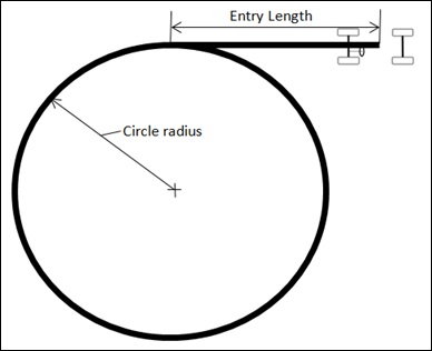

- 0->turn-in
- The vehicle drives at the prescribed speed for the entry length
distance. Entry length distance is (
2*π*circle radius/2) or ¼ the circumference of the circle. - Turn-in-> throttle delay time
- Vehicle turns into the constant radius curve and continues around the curve to reach steady state cornering.

The entry length is fixed by the event controller and cannot be changed. The entry length distance is (2*π*circle radius/2) or ¼ the circumference of the circle. The entry length is provided so that the vehicle can reach a steady state straight line driving condition.

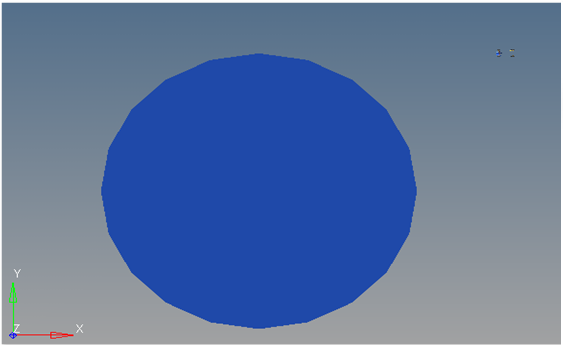

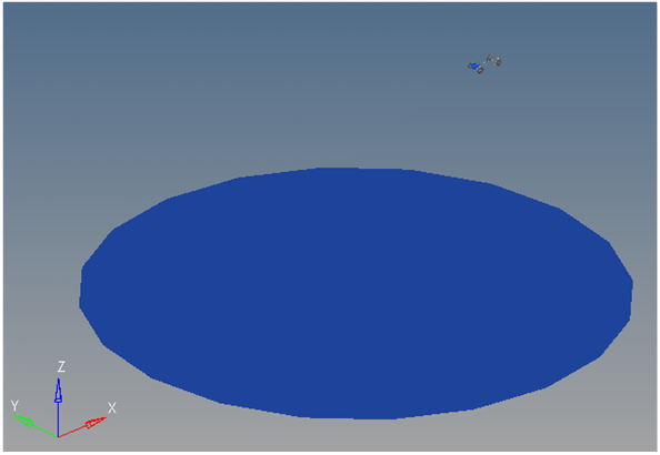

The Form is the only place that you should change the Throttle-off cornering event. Lateral Acceleration, Circle Radius of the path, Turn Direction, Throttle delay and Throttle step duration are the parameters that can be changed. The Ground z Coordinate is a calculated value and is calculated using the wheel CG Z location and the tire rolling radius from the Tire Data Form.Graphics
One graphic is defined in the event. The graphics define the road surface graphics and should not require any user input.
Skidpad graphics are included to illustrate the path being driven and are defined parametrically using the data in the Throttle-off cornering Form. Skidpad graphics should never require editing unless the event is being fundamentally changed.
