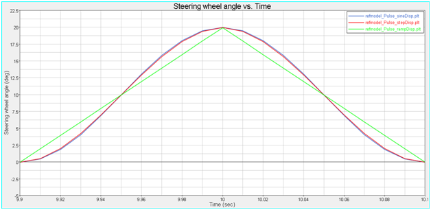

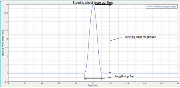

A Pulse steer event simulates a vehicle response to a sudden pulse input to the steering wheel while driving in a straight line at a constant speed. The input to the event can be a steering wheel torque or angle, and you can set the pulse magnitude and width. The pulse can be input as a sine, step, or ramp function and you control the width. A drive torque controller is used to maintain a constant speed, and standard outputs for the vehicle and tires are included in the tire System and the output requests system. A plot template is available to plot the results.

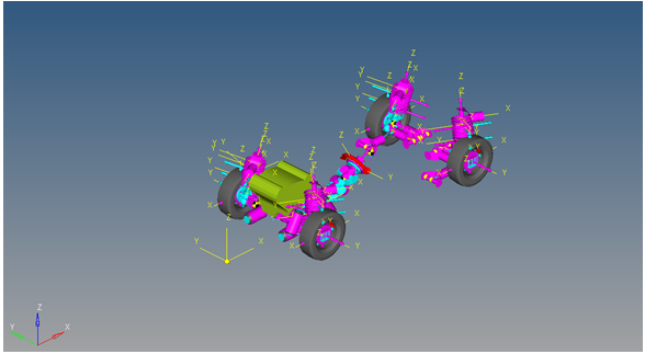

This event is designed to work with a full vehicle model that has been built through the MotionView Assembly Wizard. The event should attach to the model automatically when added through the Task Wizard. It can be used with models built manually, as long as the attachment scheme in the event is strictly followed.

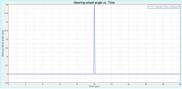

This event is used to determine vehicle response to a sudden pulsed input at the steering wheel. Event parameters are entered on the event form.
Steering Wheel Displacement

| 0++ | Dynamics | Dynamic event begins with the steering wheel fixed at 0 and the torque controller maintaining constant speed. |
| 10-1/2 (Length of Pulse) |
Pulse Begins | The pulse event begins, using the method specified in the event form. |
| 10+1/2 (Length of Pulse) |
Pulse Ends | The pulse event ends, using the method specified in the form. |
| 20 | Event End | The event terminates. Modify the end time by editing the event template. |
- The steering pulse equations are defined in the event template and refer to the dataset values that are entered using the event form. Advanced users can modify the event by editing the template.
- Our studies indicate that the displacement input method is more stable than force input.

- The Vehicle velocity field determines the velocity the vehicle maintains during the event. Enter a value.
- Enter the steering input type by making a selection in the drop down menu. Angle applies a step angle into the steering wheel; torque applies a step torque into the steering wheel.
- The steering input magnitude determines the magnitude of the steering input that is applied, in either degrees or Newton-mm. A positive value results in a left turn and a negative value turns the vehicle right.
- Enter the length of the pulse, in seconds.
- Select the function type used in the pulse portion of the event.
