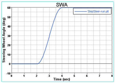

| 2-4 seconds (Steering Input Start time-> Steering Input End time) |
Steering angle is rapidly increased from 0 to the max steering value (default 60 degrees) using the prescribed function (sine, step or ramp). |
| 4-8 seconds (Steering Input End time-> Steering Input End Time + 4 seconds) |
Steering is held at the max steering value while the vehicle responds. The end time can be changed in the event template if required. |
This event is designed to work with a full vehicle model that has been built through the MotionView Assembly Wizard. The event should attach to the model automatically when added through the Task Wizard. It can be used with models built manually, as long as the attachment scheme in the event is strictly followed.
In this event, the vehicle is driven straight at an initial velocity of 55 mph for 2 seconds to reach steady state. From 2 to 4 seconds, the vehicle is steered from zero to the prescribed value (default is 60 degrees) using the function selected in the event form (sine, step or ramp). After 4 seconds, the steering wheel is held fixed at the same angle or torque until the end of the simulation.
The initial vehicle velocity, steering input start and end time, and maximum steering angle can be modified via the event form (shown below). The type of steering input can be input type angle or torque. There is a choice of three function types: Sine, Step, and Ramp, which describe the ramp from zero to the “stepped” input.
The default step input time is 2 seconds. Most steering tests are run with a faster input. The ISO 7401:2003 specification recommends the time between 10% and 90% of the steering wheel input be no more than 0.15 seconds. A steering event with a step time of 0.1 seconds (2.1-2.0) will meet these requirements. Extremely quick step inputs (under 0.02 seconds) may result in absurdly high forces in the steering system.
