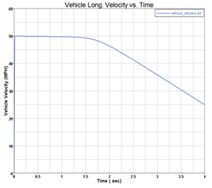

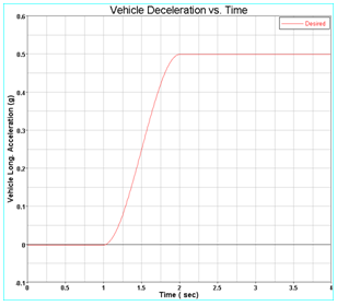

- Time
- Description
- 0-1 second
- Vehicle settles into steady state at the initial velocity entered on the event Form (default is 50 mph).
- 1-2 seconds
- Transition from steady state to the prescribed deceleration rate.
- 2-4 seconds
- Vehicle is at steady state deceleration.
The initial speed and the desired acceleration can be modified via the event form. You can also change the steering condition, which can be locked or free.

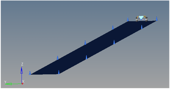

Eleven graphics are defined in the event. The graphics define the cones and the straight road graphics and should not require any user input. A full description of the graphics can be found here.
The Road graphics are included to illustrate the path being driven and are defined parametrically using the data in the Straight line braking Form. All road graphics are used to illustrate the lane dimensions, but they are not of the actual road used for calculating tire forces. Road graphics should never require editing unless the event is being fundamentally changed.
