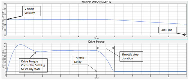

In this event, the vehicle drives at the vehicle velocity down a straight road and follows a line on the centerline of the road using the driver controller. The drive torque controller maintains the vehicle speed. At the throttle delay time, the drive torque begins to be removed and is removed over the throttle step duration time using a function. The event ends at the end time. Data is output to the plot and graphics files every time step seconds.
The test is a common vehicle characterization test and is used to understand the vehicle response to a sudden removal of throttle torque. Vehicle dynamics engineers are typically interested in the vehicle state responses and the tire behavior during the event. All of these signals are saved to the plot file.

- Throttle Delay (sec)
- The absolute time, in seconds, when the throttle torque begins to be transitioned to zero.
- Throttle Step Duration (sec)
- The length of time the throttle controller takes to remove all torque from the drivetrain. The removal is done using the step function.
- End Time (sec)
- Absolute end time of the event, in seconds.
- Time Step (sec)
- The output step size. Data is written to the output plot and graphics files at this time interval.

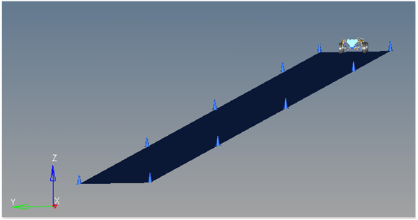

Ten types of modeling element containers are used to define the event. Three sub-systems (output requests, a steer controller, and a drive torque controller) are also included in the event.
Curves
A single curve is included in this event. The steering controller follows the path defined by the curve. The curve is on the centerline of the lane path (global Y=0) and uses the values of the odd numbered cone points to parametrically define the X and Z coordinates.
Datasets
One dataset is used in the system and it contains the data used to describe the Power-off in a Straight Line event. The event allows you to set the vehicle control, lane graphics width, throttle delay, throttle step duration, end time, and time step. The wheel rotational velocities and ground height (shown in a blue background below) are calculated values. You can change the vehicle event data in the event form.
Forms
The form is the only place that you should change the inputs for the Power-off in a Straight Line event. Vehicle velocity, lane graphics, throttle delay, throttle step duration, end time, and time step are the parameters that can be changed. The ground z coordinate is a calculated value and should not be changed.

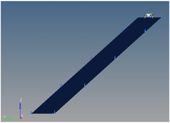

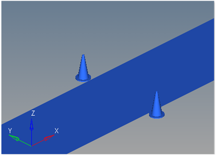

Graphics
Eleven graphics are defined in the event. The graphics define the cones and the straight road surface and should not require any user input. A full description of the graphics elements can be found here.
Joints
A ball joint is included in the Power-off in a Straight Line event. The joint attaches a dummy body to the steering rack. The joint is included to make certain events work in ADAMS. Attach the dummy body to the steering rack if building a model manually.
Markers
Five markers are included in the Power-off in a Straight Line event. The path origin is the origin of all lane change graphics and is parametrically defined to be the CG of the vehicle body. The four remaining markers are used to define the four corners of the road surface graphic element. The markers refer to points and the points contain the parametric logic to define the road surface.
None of the markers should require any user input.
Motions
Three motions are included in the event. The steering motion to the vehicle is provided by the steering controller and acts on a revolute joint that connects the steering column to the vehicle body. If a steering column is not included in the model, the joint acts between the steering rack input shaft and the vehicle body.
The front and rear wheel motions act on the wheel spindle revolute joints that connect the wheel hub to the knuckle. The motion is initially zero (fixing the wheels to the knuckle) so the model converges statically. The wheel lock motions are deactivated after the convergence of the static analysis to allow the tires to rotate during the dynamic analysis.
Points
Fifteen points are defined in the event. All points are used to create the lane graphics and graphics for the cones used to illustrate the lanes. The points contain parametric logic to define their X, Y, and Z locations. Points are approximately every 100 meters along the road edge. You should not need to modify any points.
Solver Variables
The Power-off in a Straight Line event contains one solver variable, the Steer Path variable. The Steer Path variable defines the path for the steer controller. The event uses the lane path curve as the desired path.
