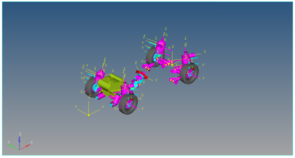

This event is designed to work with a full vehicle model that has been built through the MotionView Assembly Wizard. The event should attach to the model automatically when added through the Task Wizard. It can be used with models built manually, as long as the attachment scheme in the event is strictly followed.

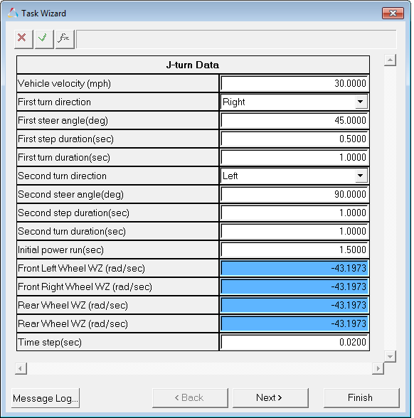

| Input | Units | Description |
| Vehicle Velocity | MPH | Initial vehicle velocity. |
| First Turn Direction | Right or Left | Not used. |
| First Steer Angle | Degrees | Angle in degrees of the initial steer input. A positive number turns the vehicle right and a negative number turns the vehicle left. |
| First Step Duration | Seconds | Time required to input the first steer angle. The step function is used to input the angle to the steering wheel. |
| First Turn Duration | Seconds | Time the steering is held fixed at the first steer angle. |
| Second Turn Direction | Right or Left | Not used. |
| Second Steer Angle | Degrees | Angle in degrees of the second steer input. A positive number turns the vehicle left and a negative number turns the vehicle right. |
| Second Step Duration | Seconds | The time required to input the second steer angle. A step function is used to input the angle and uses the second turn duration and second steer angle as inputs. |
| Second Turn Duration | Seconds | The time the vehicle steering is held at the Second steer angle input. The event ends 1.5 seconds after the second turn duration time occurs. |
| Initial Power Run | Seconds | The time at the beginning of the event. This time is typically used to verify the vehicle is at a steady state velocity. The event has an additional 0.5 seconds of fixed time added at the start of the event. |
| Front Left Wheel WZ | Rad/Sec | Right front wheel rotational speed. Do not modify this because it is a calculated value. |
| Front Right Wheel WZ | Rad/Sec | Left front wheel rotational speed. Do not modify this because it is a calculated value. |
| Rear Wheel WZ | Rad/Sec | Right rear wheel rotational speed. Do not modify this because it is a calculated value. |
| Rear Wheel WZ | Rad/Sec | Left rear wheel rotational speed. Do not modify this because it is a calculated value. |
| Time Step | Seconds | Output data time step. Data is written to the output files every time step seconds. |

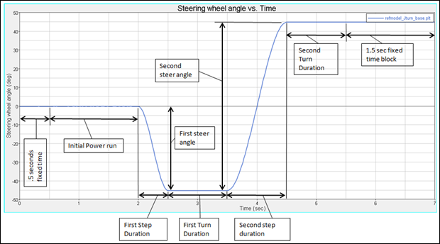

The event sequence is as follows:
| Time | Label | Description |
| 0 | Statics | Static analysis is performed on a vehicle fixed to ground. |
| 0+ | Joint release | Two joints holding the vehicle to ground are released; the joint holding each wheel to the spindle is released. |
| 0++ | Begin dynamics | Dynamic simulation begins. The steering wheel follows the input defined by the J-turn Steer Motion solver variable. |
| .5 + Initial Power run | Start first steer event | The initial steer input begins. The step function rotates the steering wheel from 0 to the first steer angle in the first step duration time. |
| + first step duration | End first steer event/begin first steer hold | The initial steer event is complete and the first turn duration time begins. The steering wheel is held at the first steer angle input. |
| +First turn duration | Steer hold complete/ begin second step input | Steering hold is complete and the second steering input begins. The second steering input is done as a step function using the second steer angle and the second step duration as inputs. |
| +second step duration | Second steer input complete | The second steer input is complete and the wheel is now held fixed for the second step duration time. Note that the resulting steer angle is the net angle of the first and second input. |
| +second turn duration | Second steer hold is complete | Steering is held fixed for the second turn duration time period. |
| +1.5 sec | Vehicle reaction time | Steering is held fixed. |
| Event end | End | Event ends. |
