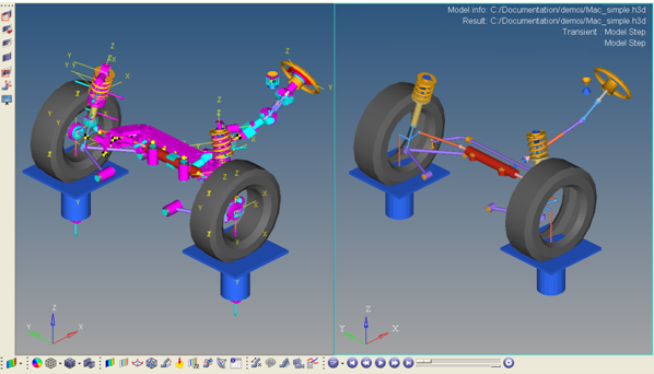

Select either the Animate or Plot
button (located on the far right side of the panel). Both buttons should now be
active.
Animate opens another window and creates an animation of the simulation results. Always examine the animation to verify the results are reasonable. The animation window should be used to understand the model results. The following uses are recommended:
- Add force requests and animate the forces in the model.
- Add CAD geometry and identify clearance issues.
- Zoom, rotate, and pan in the model to understand the model displacements.
Selecting Animate will add a second window (on the right).Figure 1.

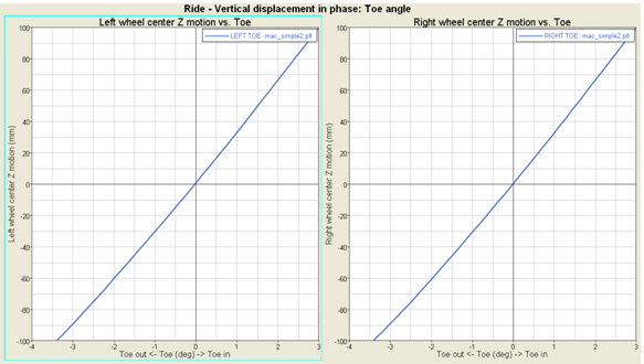

Suspension Design Factors can be plotted using HyperGraph. The data is available in either the .req or the .abf file written from MotionSolve. A sample plot is shown below:
