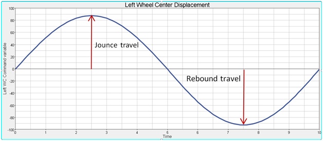

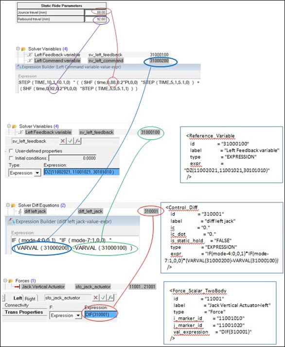

Many of the half car analyses use a control system to displace the wheels in jounce and rebound. The system applies a force on the jack to move the wheel center through a displacement defined by the left command variable and right command variable. The control system only works while running statics and quasi-statics solutions.
- Jounce travel and rebound travel are entered in the Static Ride Parameters form. Travel is assumed to be symmetric.
- The solver variables left command variable (shown) and the right command variable (not shown) refer to the travels from the Static Ride Parameters form.
- The equations in the left command variable and right command variable create a sin wave which has a positive peak at 2.5 seconds with a magnitude equal to the jounce travel, and a negative minimum at 7.5 seconds at the rebound travel magnitude. The solver equation is further explained in the Solver Variables section below.
- The solver variables left feedback variable and right feedback variable are defined. The variable is the displacement of the wheel center on the wheel, relative to the original wheel center position, in the global Z direction.
- The solver differential equation is defined (for left and right side) to be the difference between the command variable and the actual variable. If the wheel center displacement follows the command variable, the differential equation will be zero. The eifferential equation is set to zero for solution e=sequences other than statics and quasi-statics using IF statements and the MODE variable.
- A force is defined that is equal to the control differential of the wheel.
- The solver differential equation maintains the wheel displacement due to the following property: “For static and quasi-static solutions, the derivative of the dynamic state is set to zero. This converts the Control_Diff to an algebraic equation for these two analyses.”

The wheel control system form is shown below. The Static Ride Parameters form contains the jounce and rebound travel that are applied to the suspension system. Travel is symmetric (L<->R). The jounce and rebound variables are defined in the suspension travel dataset. Dataset types and variable names are defined in the dataset; data is normally entered on the form.

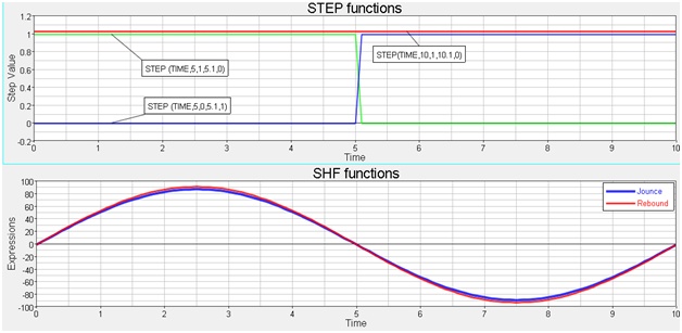

- STEP(TIME,10,1,10.1,0)
- A step function that is one when Time is less than 10 and zero when time
is greater than 10.
This makes the entire equation evaluate to zero after T=10.
- SHF(time,0,88,0.2*PI,0,0)
- A simple harmonic function, Time based, Time offset of zero, magnitude of 88, Frequency=.2*pi, with zero phase shift and a zero average value.
- STEP(TIME,5,1,5.1,0)
- A step function that is one when time is less than 5 and 0 when time is
greater than 5.1.
This turns the jounce SHF off when T>5.1.
- SHF(TIME,0,92,0.2*pi,0,0)
- A simple harmonic function, Time based, time offset of zero, magnitude of 92, Frequency=.2*pi, with zero phase shift and a zero average value.
- STEP(TIME,5,0,5.1,1)

The left and right side of the actuator force pair behave in the same manner. The force acts on the jack and is reacted on ground. The force acts in the vertical direction. The force is set to the DIF(308001) magnitude. When the DIF is evaluated during statics and quasi-statics, the derivative of the solver differential equation is set to zero. The result is that a force is generated by the DIF that forces the measured wheel displacement to follow the command wheel displacement.
- The prescribed wheel displacements for left and right wheel center Z displacement are defined by the expressions in the solver variables left command value and right command value.
- The force required to maintain the wheel displacement is defined by the force pair jack vertical actuator and is a pure Z force on the jack body on each side of the vehicle. This is set equal to the DIF value.
- The actual wheel displacements in the Z direction are defined by the solver variables left feedback variable and right feedback variable.
- The controls are defined in the diff left jack and diff right jack solver differential equations. They are the command solver variable minus the feedback solver variable. This will equal zero if the wheel is following the command input
- The solver treats the solver differential equation as an algebraic equation in statics and quasi-statics mode. As a result the DIF value is the force required to maintain the commanded wheel position.
