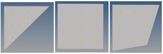

- num_samples=<value>
- The number of samples used for analysis per each edge of quad and the maximum number
of samples per each edge of tria element. This is an optional argument. By default, one
sample is used per each element. Each sample point is chosen inside the element. The
figure below shows the sample points for num_samples set to 3.
