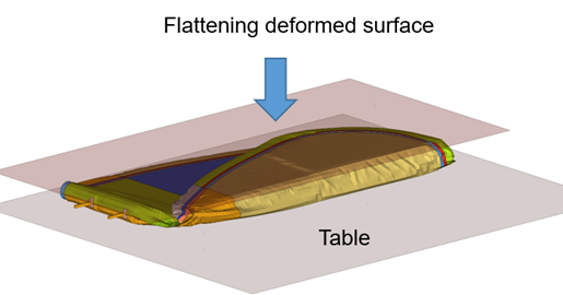

Creates a flatten fold setup for solver run to get the resulting position of airbag.

Creates a flatten fold setup for solver run to get the resulting position of airbag. The folding table must be created using *createfoldingtable before running the command.
